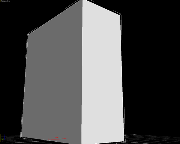

jvlive Posted December 8, 2005 Share Posted December 8, 2005 i have this poly object which is very rectangular (orthagonal?) with all its divisions, extrusions, depressions. now i want one plane to be curved. i can't use mesh smooth because i want the rest of the object to remain orthagonal. i know this is simple to do with a new object and just attach it to the original poly, but i just wanna know if there's a way to do this just by editing the original object. quite some time ago i encountered this tutorial somewhere (cant find it now) related to this and it was using a mesh select modifier below a mesh smooth mod to "localize" the smooth effect to selected polygons.... pls do explain mesh select if this is indeed the way. thanks in advance. Link to comment Share on other sites More sharing options...
noi-pi Posted December 8, 2005 Share Posted December 8, 2005 You need to cut again a segment at the center. Then Under polygon Sub-object select either side poly....then click Hinge from Edge...then Pick that center edge. Enter 180 and enter some segments to round it off. Cheers. Link to comment Share on other sites More sharing options...

jvlive Posted December 8, 2005 Author Share Posted December 8, 2005 wow. thanks a lot, herminio! as mentioned by david, it does make one understand quickly. salamat, bro! Link to comment Share on other sites More sharing options...
