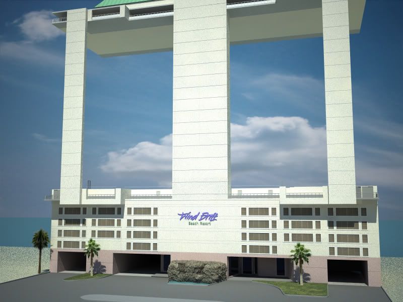

Billabong Posted January 17, 2008 Share Posted January 17, 2008 I am having a problem with a building I'm rendering, I can't seem to get away from this toy look of it, and was hoping someone might have a suggestion, I'm using an hdri in the enviroment and a target direct for the sunlight with a standard target camera set to 35 mm using IR for primary bounce and Light Cache for second and set on Linear fro color mapping Link to comment Share on other sites More sharing options...
Aaron2004 Posted January 17, 2008 Share Posted January 17, 2008 I personally don't use HDRI with exterior shots. I don't think its too common. The first thing that makes it look fake is the background and the sky interacting with the water. If I scroll up so that I only see the top of the building, it doesn't look to bad. Your standing seam roof needs more highlighting and displacement, your windows at the bottom need to reflect the environment and interact with the light more. As far as I can tell, your modeling isn't what's holding you back. It's your textures and your shaders. Link to comment Share on other sites More sharing options...
Spooner04 Posted January 17, 2008 Share Posted January 17, 2008 The last half of this post would be relevant here I think. http://www.cgarchitect.com/vb/27976-photoreal-advice-2.html#post190696 You probably don't want to use the hdri for the background. It looks very fake. Link to comment Share on other sites More sharing options...
Billabong Posted January 17, 2008 Author Share Posted January 17, 2008 Thanks Aaron, ill try something different than hdri, the windows at the bottom are actually vents for a parking garage, i dont think their showing up to well because I have the AA turned off right now and thanks Sponner Link to comment Share on other sites More sharing options...
Aaron2004 Posted January 17, 2008 Share Posted January 17, 2008 Also...if your using VRAY, I would take advantage of the Vray Sun+Camera. It could really help your scene. You could still make a nice render with your current light+camera setup....but your not taking full advantage of VRAY. Link to comment Share on other sites More sharing options...
Eric Sosa Posted January 17, 2008 Share Posted January 17, 2008 long way to go for a realistic render m8...but u got the elements to do it colours: vegetation, sea & some of the building textures look realy cartoonish. shadows & ligthning need big changes, as pointed out before....well u need to start somewhere..good luck Eric Link to comment Share on other sites More sharing options...
Billabong Posted January 17, 2008 Author Share Posted January 17, 2008 Thanks Eric Link to comment Share on other sites More sharing options...
Billabong Posted January 17, 2008 Author Share Posted January 17, 2008 by the way Aaron, I took your advice and switched to the Vray sun and camera which did help it a lot, and right now Im concentrating on the actual grass, will post an update soon. Thanks Link to comment Share on other sites More sharing options...
Horhe Posted January 17, 2008 Share Posted January 17, 2008 Overall the image is too saturated especially the vegetation. Link to comment Share on other sites More sharing options...

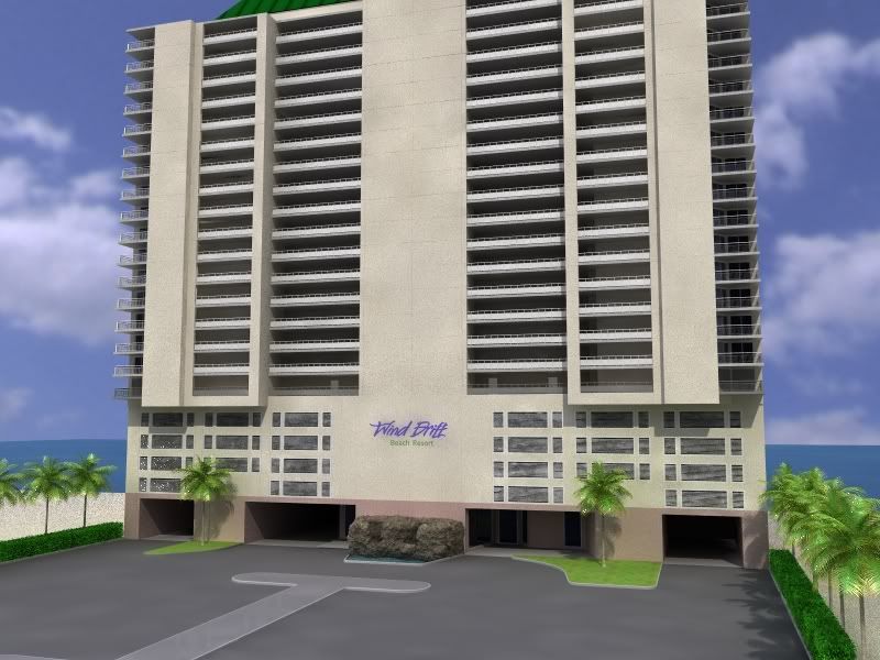

Billabong Posted January 18, 2008 Author Share Posted January 18, 2008 Thanks Horhe I need some advice on my alpha trees, Ive read the 2 part series that Brian made, but want i want to know is what is the best way to go about this. the two trees in the front are a single plane and the one on the far left is 4 planes. I tried doing the 4 planes on the the two front trees, but you could actually see the different planes when rendered, is it best to just leave them on one plane or should I add a uv map set to face with 4 planes. Thanks for any help. So far I worked on my grass, which I think came out very well and I also have a good bit of stuff hid in this render just so I could speed up my render times for tests. Thanks again Link to comment Share on other sites More sharing options...
Ricardo Eloy Posted January 18, 2008 Share Posted January 18, 2008 IMHO, the best approach is to use 3D trees. When going all physical like you are (using VRaySun and stuff), alpha trees normally give away they're not real, so you'd be much better off using geometries instead of mapped planes. Link to comment Share on other sites More sharing options...
Billabong Posted January 18, 2008 Author Share Posted January 18, 2008 Thanks Rick, I'm just having hard time getting some good trees, I really dont have the cash right to fork out for onyx and I had that Evermotion dvd of trees which is what I used originally, but they looked more plastic than anything, I am thinking about trying the RPC route on the trees and see how that goes. Thanks for your help Link to comment Share on other sites More sharing options...
