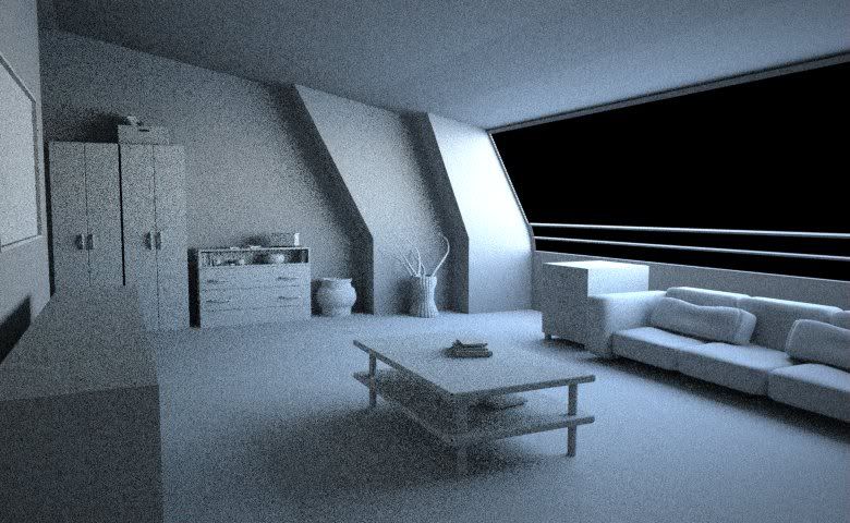

rubent100 Posted November 13, 2008 Share Posted November 13, 2008 Hello all, Im having this problem were no light shines through the windows. I have set up multiple settings on longitute and latitiue, rotated my geometry, and nothing seems to work. Here is an image of what is happening. So there is light coming through but i cant see it out of the window. It should be very bright white. Also there is a MXM glass material on the window panes, but even if i remove them it still doesn't show. I know if i add dome light it will work, but it should also work with physical sun and sky. Link to comment Share on other sites More sharing options...

rubent100 Posted November 13, 2008 Author Share Posted November 13, 2008 Maxwell, and my settings are. Ozone .300 water 2.00 tub = 0.080 wave .250 aerosol 85. scattering .700 shopw sun enabled temp 5777 power 1.5 planet reflec 40. long -2. lat 40. hour 13 minute 24 Link to comment Share on other sites More sharing options...

Bwana Kahawa Posted November 14, 2008 Share Posted November 14, 2008 I've sometimes had this - it doesn't show up in the MX Studio viewport either? Found the only solution is to re-export it, or else load a default sky once I'm in Studio and then change the parameters to match what I want. As long as you see a blue sky in the viewport, you should then see it in your scene. Yet another of Maxwell's 'quirks'... Link to comment Share on other sites More sharing options...
rubent100 Posted November 15, 2008 Author Share Posted November 15, 2008 I've sometimes had this - it doesn't show up in the MX Studio viewport either? Found the only solution is to re-export it, or else load a default sky once I'm in Studio and then change the parameters to match what I want. As long as you see a blue sky in the viewport, you should then see it in your scene. Yet another of Maxwell's 'quirks'... Hi Bwana, i might give it a try and re export it. But i do see the sky in the viewport and not in my render. I'm not really sure what is going on. This alone has lead me to stop using maxwell to render. I wish there was a solution to this. I'll keep trying to find a solution i guess. Link to comment Share on other sites More sharing options...
