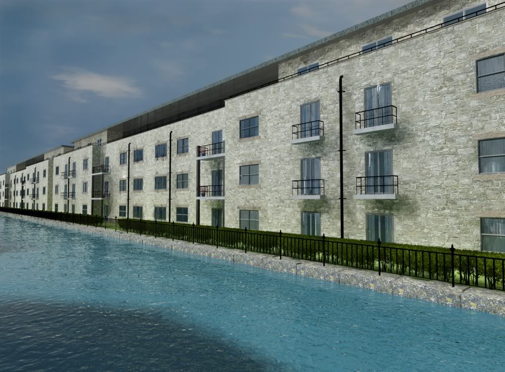

Macca23 Posted July 16, 2009 Author Share Posted July 16, 2009 Heres a final update of how i want the apartments looking, added the sky in photoshop no other work in post production. C & C please before i add it to finished work section. Sorry for the large image. Link to comment Share on other sites More sharing options...
Matt McDonald Posted July 16, 2009 Share Posted July 16, 2009 Have you thought about swinging the sun around to the other side? Right now its basically coming from behind the camera which flattens out what little articulation the building features. I think that you need to look for additional ways to break up the rendering. Varying the hedge some or swap it out with something else every few meters. Put some stuff on the patios. People walking down below. Break up that shadow in the water. This rendering is for sh!ts and grins right? Why not break up the sea wall and make a nice little pedestrian area?That's a lot of stuff but I think its what you need to really get some pop out of that rendering. BTW if you are having trouble making a better hedges due to particle limitations, make one as long as you can, apply mesher, proxy it out and then make another one using different parameters. Good luck man, and keep posting! Link to comment Share on other sites More sharing options...

cadmunkey Posted July 19, 2009 Share Posted July 19, 2009 What happened to the curtains and blinds? Looks good, but I agree that you need to change the angle of the sun. Link to comment Share on other sites More sharing options...
Ernest Burden III Posted July 19, 2009 Share Posted July 19, 2009 Flood insurance? Have you thought about swinging the sun around to the other side? That would help a lot. Besides the flattening, having the sun the way you have it makes the shadows point along the lines of the composition towards the oblivion just off the left edge of the picture. Try the sun rotated so the balconies cast their shadows towards the right a little. Play with the angle, but also the vertical angle, making longer or shorter shadows. Then increase skylight or GI bounced light to brighten the shadowed areas. they read dark, dead. Link to comment Share on other sites More sharing options...
Pictor Posted July 20, 2009 Share Posted July 20, 2009 Looks good but some reflection/specular on the railings & drainpipes would lift them a bit. Also if you have the time model up some simple interior walls/floorplates with a slightly off white colour so you can see a hint of something inside. Might work better with the curtains & blinds back in but reel in the blinds a bit and lighten the colour closer to white or something subtle that will conrast a little more with the stonework. Not too keen on curtains with ties esp. in a building like this so try something more like this; http://www.turbosquid.com/3d-models/3d-curtains-model/266455 They're easy to knock up, just a single sided plane with a 100 or so width segments and slap on a ripple modifier. No need to bother with hooks etc at this distance/angle. For the material if you're using vray a simple off white vray mat with an output map set to .8 (or lower for more transparent) in the opacity channel and slot the whole material into a vray 2 sided material should do the job. Hedge looks a little dense to me, perhaps have a play with some of the free x-frog ones on Autodesk seek; http://seek.autodesk.com/product/latest/agg/xfrog/xfrog-inc-greenworks-organic-software/LS04 Will take longer to render but if you instance it there shouldn't be a problem with RAM hope this helps! Link to comment Share on other sites More sharing options...
Macca23 Posted July 20, 2009 Author Share Posted July 20, 2009 Another update here, I've rotated the suns position, added proper hedges, added curtains to the windows and added some small plants to some of the balconies. Comments please There's a few shiny patches on this one, not sure where they have come from though? Link to comment Share on other sites More sharing options...
Macca23 Posted July 21, 2009 Author Share Posted July 21, 2009 Final update of the work i want to do on it. Ive got it looking how i like and how i feel looks good. Comments still welcome though before i put it in the finished section. Not sure whether to photoshop in some clouds or leave the sky as is? Thanks Link to comment Share on other sites More sharing options...
