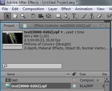

Jock Posted December 17, 2010 Author Share Posted December 17, 2010 I must be doing something wrong. I choose what channels i want included when i save the rpf and someone showed me what theirs looks like when they import it to After Effects: But the thing is mine doesnt look like, it contains no info other than 'millions of colours' Ive tried everything i can think of but its always the same. Ive tried the IDmatte but i think the problem is that the information isnt there, so it cant do anything. Link to comment Share on other sites More sharing options...

Jock Posted December 17, 2010 Author Share Posted December 17, 2010 Youre a star.... It was because i was selecting the object id in the frame buffer and saving that. when i saved the main diffuse it worked a treat. Thanks guys! Link to comment Share on other sites More sharing options...
