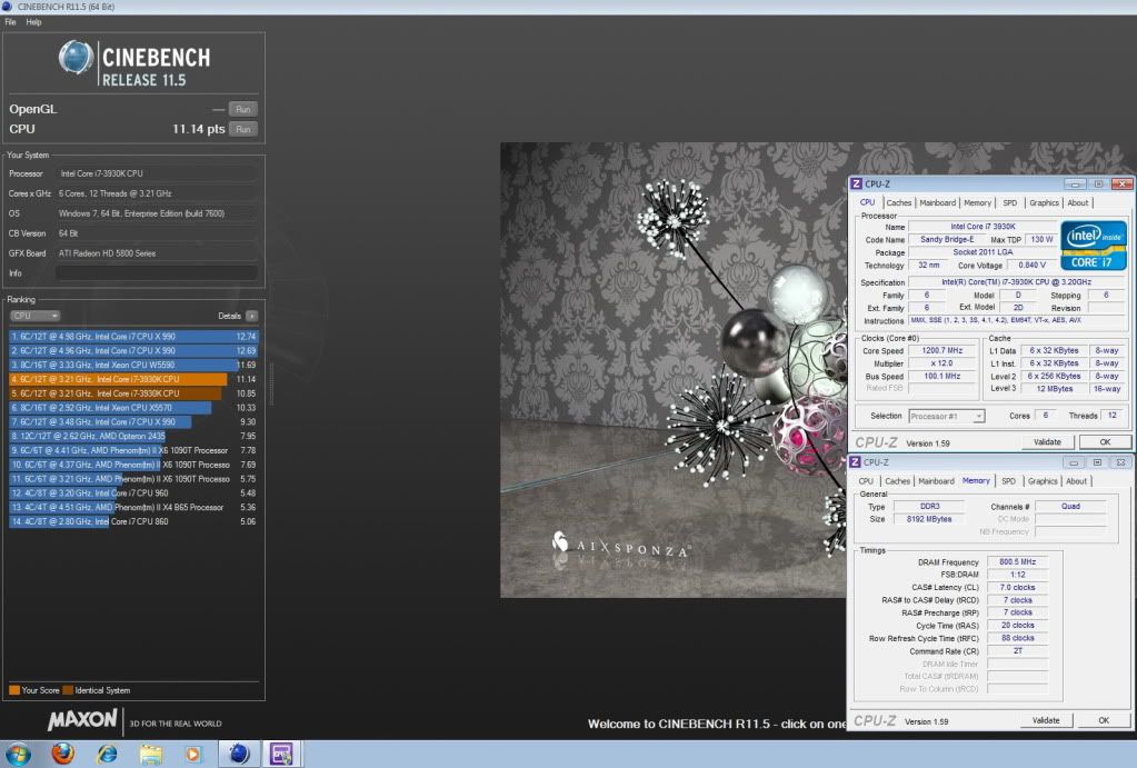

Superkames Posted January 6, 2012 Share Posted January 6, 2012 I7 3930K is a powerfull CPU : At stock speed , turbo core @ 3.8ghz (all cores) ~ 11pts with cinebench R11.5: Link to comment Share on other sites More sharing options...
aristocratic3d Posted January 10, 2012 Share Posted January 10, 2012 Is this the msi mother board behind? I7 3930K is a powerfull CPU : At stock speed , turbo core @ 3.8ghz (all cores) ~ 11pts with cinebench R11.5: Link to comment Share on other sites More sharing options...
Superkames Posted January 20, 2012 Share Posted January 20, 2012 Is this the msi mother board behind? Yes , that is the MSI X79A-GD45 [8D] . Link to comment Share on other sites More sharing options...

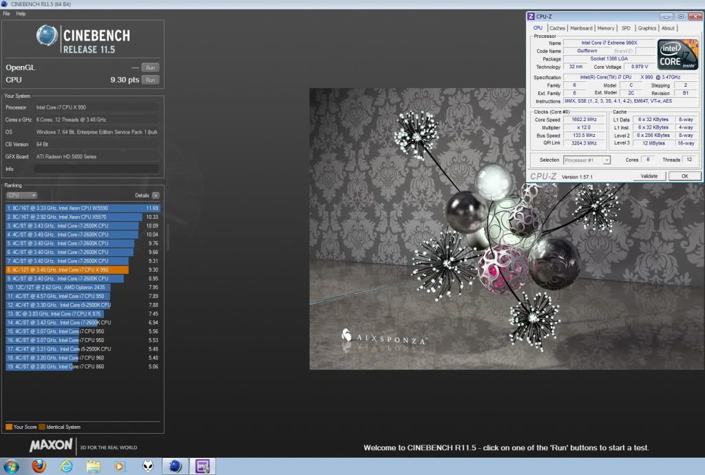

Superkames Posted February 15, 2012 Share Posted February 15, 2012 (edited) Don't buy CPUs on Ebay. You'll overpay, or get something without a warranty and not know where it's been. The 3930 is less than 10% faster than the 980, so if one needs a box built now the 980 is fine. Less than 10% , are you sure about that . @stock speed , the I7 3930K with a Asus or MSI mainboard is more than 19% faster than the I7 990X (I7 990X > I7 980 ) with heavy multithreaded apps . For example : Cinebench R11.5 . 11.14/9.3 ~ 1.19 . I think you didn't test them both before?? Edited February 15, 2012 by Superkames Link to comment Share on other sites More sharing options...
