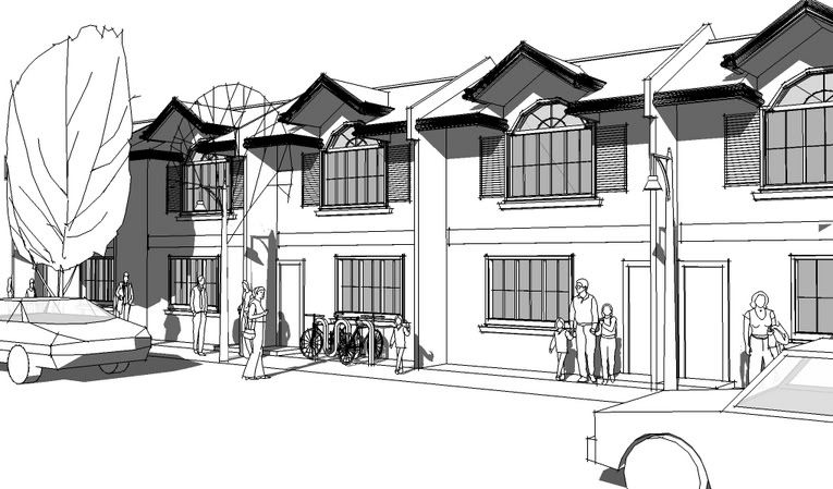

CAD Posted September 10, 2004 Share Posted September 10, 2004 Can anyone help me on how to improve the AA in Sketchup? Thanks Link to comment Share on other sites More sharing options...
STRAT Posted September 10, 2004 Share Posted September 10, 2004 the AA looks fine and smooth to me. i think you're talking about the sketchiness feel to it, not the AA. thats changed here - view > preferences > edges properties Link to comment Share on other sites More sharing options...
CAD Posted September 11, 2004 Author Share Posted September 11, 2004 Yhanks for the reply Strat. I looked it up but it has nothing to do with AA. If you notice, some lines especially those near the horizon level still appears to be too jagged. Link to comment Share on other sites More sharing options...
STRAT Posted September 11, 2004 Share Posted September 11, 2004 some lines especially those near the horizon level still appears to be too jagged. yes, but thats not an AA problem Link to comment Share on other sites More sharing options...

CAD Posted September 13, 2004 Author Share Posted September 13, 2004 Hey, now. If someone has a drinking problem, let's not try to blame it on SketchUp. Gary he he he... sorry, I don't drink... and I don't blame Sketchup. Sketchup is a GREAT SOFTWARE! Its just that I'm not that satisfied with what I see. But if you guys don't find anything wrong, then I rest my case. Link to comment Share on other sites More sharing options...
STRAT Posted September 13, 2004 Share Posted September 13, 2004 aye, thats literally one of Sketchup's characteristics. you'll soon get used to it. Link to comment Share on other sites More sharing options...
Craig Ramsay Posted September 13, 2004 Share Posted September 13, 2004 Thet AA doesn't look too good to me, the lines look very jaggy. Try rendering out your image larger and make sure you tick the AA box in the export options. Link to comment Share on other sites More sharing options...
Cesar R Posted September 15, 2004 Share Posted September 15, 2004 There is an AA option when you to export 2D graphic. On the save window click on options its righ by the save button. Link to comment Share on other sites More sharing options...
chuck Posted September 15, 2004 Share Posted September 15, 2004 I agree sketchup's AA needs a bit of improvement. Some of the people that hang out on the sketchup site recommend rendering the image twice the size you want with AA off, then bringing it into PS and resizing it, with image resampling-bicubic filtering. It seems PS is better at it than sketchup... chuck Link to comment Share on other sites More sharing options...
CAD Posted September 16, 2004 Author Share Posted September 16, 2004 Thanks for reply guys. I think the AA tick box is only accesible in v4. I used v1.31 on the image above. Now I'm trying out v4. One last thing. Is there any way I can improve the smoothness of curved lines of imported DWG files to Sketchup? Notice those transom windows? They were not supposed to be pointed. It should be smooth. I use AutoCAD to model my scene then move it Sketchup. Any help will be much appreciated. Thanks for the ideas and comments. Link to comment Share on other sites More sharing options...
Ferrari_Italy Posted September 22, 2004 Share Posted September 22, 2004 thats changed here - view > preferences > edges properties No view > preferences > edges properties for me! Is that because I'm using the 8hr version 4.0 or has it moved? Link to comment Share on other sites More sharing options...
archFX Posted October 7, 2004 Share Posted October 7, 2004 CAD... if you are using 4.0 you can simply select the arc or circle and then right click to open the "entity info" dialogue box... in this dialogue, change the number of segments in the arc or circle. Unfortunately it does allow you change the number of segments once the face is pushed/pulled. Also, if you are modeling in autocad you can change the number of segments before importing to skecthup... good luck... take care... ps. i would just like to echo everyone else's sentiments about SketchUp... excellent design tool! The sketchyness is refreshing! Link to comment Share on other sites More sharing options...
