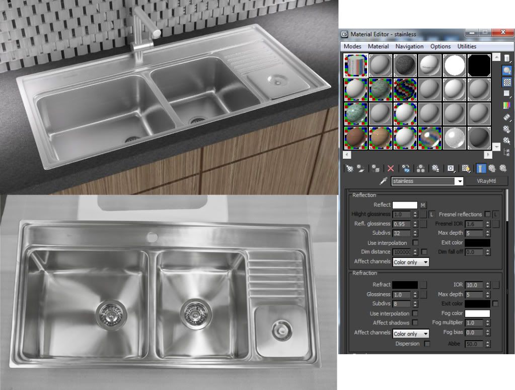

neyes_ice Posted May 8, 2012 Share Posted May 8, 2012 Hi Guys, need help on a project, how can I make my brushed stainless material to look more like the actual photo below? I have tried material presets from archshaders and sigershaders but none of them does the job, the attached render is from sigershaders but i tweaked it a little bit. I have looked around so many tutorials to achieve the desired look but its still not close enough. Let me know for suggestions, any would do, staight from 3dmax and vray or photoshop. Thank you for your time. Link to comment Share on other sites More sharing options...
DavidRees Posted May 9, 2012 Share Posted May 9, 2012 anisotropic reflection, rotate 90 degrees if you want. For a better effect, unwrap your model and put a 'scratch' map in the reflect + bump slots. Link to comment Share on other sites More sharing options...
John Dollus Posted May 9, 2012 Share Posted May 9, 2012 what you have is fine - just adjust the levels in post. Link to comment Share on other sites More sharing options...
RyderSK Posted May 9, 2012 Share Posted May 9, 2012 One of the secrets is warped 3D model, make it more higpoly and put noise modifier, you can also put additional bump map for this (apart from scratch bump). Other is, anisotrophy. And yeah, the Sigger shaders are nothing special. Link to comment Share on other sites More sharing options...
salvador Posted May 10, 2012 Share Posted May 10, 2012 Agreed. Use Ward instead of Blinn or the others and play with the anisotropy level and rotation; also, adjust your reflection value. Link to comment Share on other sites More sharing options...
neyes_ice Posted May 12, 2012 Author Share Posted May 12, 2012 Thank you very much for the input guys, The image got cut, it is a ward material with a anisotropic rotation of 90, I could live with the result if it was my personal project but the client wants it to be perfect. Will try Juraj's suggestion. thanks. Link to comment Share on other sites More sharing options...
johannes Posted May 12, 2012 Share Posted May 12, 2012 Because of the drain, the bottom bit is not flat. Bending it a bit could help to get more realistic reflections. Link to comment Share on other sites More sharing options...
salvador Posted May 15, 2012 Share Posted May 15, 2012 Just a thought. In the actual photo there seems to be a white very diffuse light above and the sink appears in parts almost white. Could it be that preventing it from looking like your rendered one? Can you get more photos of the piece just to compare? Link to comment Share on other sites More sharing options...
