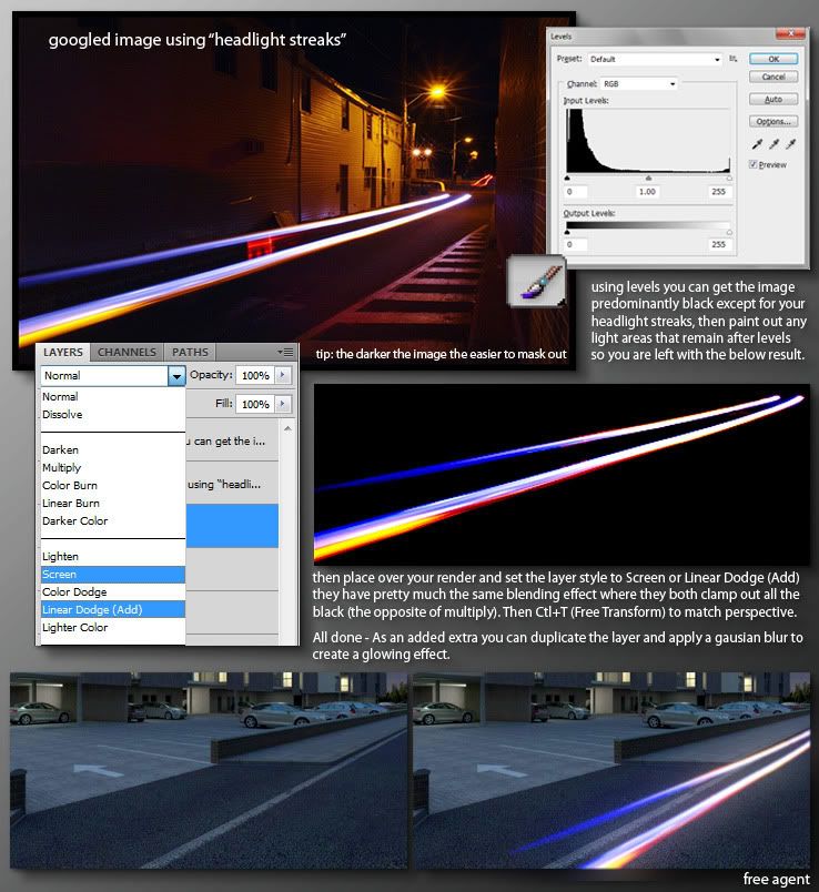

BVI Posted December 13, 2012 Share Posted December 13, 2012 The light glows from the car headlights, breaks, rear lights etc never look good when you comp in a photo and then bring down the transparency - Better to do these as PS effect combined with a photo. Shane Gee did a nice tutorial here: http://i167.photobucket.com/albums/u143/FreeAgent84/Headlightstreakstuto.jpg Also, pull up your contrast and up the down the brightness to get more definition on the image. What I found with most projects is that the scene should be about 50% of the image, by that I mean that you should add lots of detail to the environment as your would the building. You can add loads more people walking around - more planting on the sidewalk, a few cars driving around etc. Your curb detail needs work - it's right in the foreground. Also, the sky image is very low res and the background plate is at an odd angle. Every commercial image that you do should be a place you would like to hang out and visit. Link to comment Share on other sites More sharing options...
