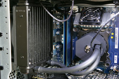

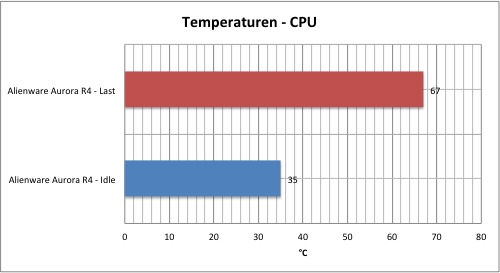

numerobis Posted September 4, 2013 Share Posted September 4, 2013 (edited) So you're using CPUID HWMonitor right? http://www.cpuid.com/softwares/hwmonitor.html I'm not sure if it is reading the temps correctly. I have seen on other forums that people had problems with it. I would check the temps with CoreTemp http://www.alcpu.com/CoreTemp/ (but if you install it use custom install and skip all these shitty free offers...) Here is a review of the 4,1GHz version of the Aurora R4 http://www.hardwareluxx.de/index.php/artikel/hardware/komplettsysteme/21288-test-alienware-aurora-r4.html?start=4 They are getting max load temps of 67°C under prime95! So i think there is definitely something wrong when you get higher temps at 3,9GHz without prime. Is this the CPU cooler you are using? Edited September 4, 2013 by numerobis Link to comment Share on other sites More sharing options...
junglee Posted September 4, 2013 Author Share Posted September 4, 2013 So you're using CPUID HWMonitor right? http://www.cpuid.com/softwares/hwmonitor.html I'm not sure if it is reading the temps correctly. I have seen on other forums that people had problems with it. I would check the temps with CoreTemp http://www.alcpu.com/CoreTemp/ (but if you install it use custom install and skip all these shitty free offers...) Here is a review of the 4,1GHz version of the Aurora R4 http://www.hardwareluxx.de/index.php/artikel/hardware/komplettsysteme/21288-test-alienware-aurora-r4.html?start=4 They are getting max load temps of 67°C und prime95! So i think there is definitely something wrong when you get higher temps at 3,9GHz without prime. Is this the CPU cooler you are using? Yes, that is the exact picture of the my computer. Holy cow, 67 only????????????? I get that as soon as I open 3dmax. I'm going to measure with Coretemp and report back... Link to comment Share on other sites More sharing options...
