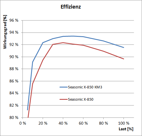

Dimitris Tolios Posted December 12, 2013 Share Posted December 12, 2013 Pretty solid built by numerobis. The PSU could be smaller - you won't need more than a good quality (i.e. you cannot go wrong with Seasonic) 500W PSU if you are not overclocking that 4930K, and you could also "side-grade" to a H80i (or a $30-40 air cooler) if you won't be overclocking. Otherwise this is a solid build, with almost nothing excessive / overkill etc. Link to comment Share on other sites More sharing options...
Stephen Thomas Posted December 12, 2013 Author Share Posted December 12, 2013 Really appreciate the input guys, thanks for taking the time. I think I would overclock, having done it on the last two incarnations of my current PC (e6600, q6600 and memory voltage plus factory OC'd GPU). Could do with refreshing my knowledge on the subject first though. Link to comment Share on other sites More sharing options...
Stephen Thomas Posted December 12, 2013 Author Share Posted December 12, 2013 I like the look of the Gigabyte card, numerobis. Would it be worth keeping a larger capacity psu in case I decided to add another 1 or 2 in the future? Link to comment Share on other sites More sharing options...
Dimitris Tolios Posted December 12, 2013 Share Posted December 12, 2013 (edited) stef.thomas said: I like the look of the Gigabyte card, numerobis. Would it be worth keeping a larger capacity psu in case I decided to add another 1 or 2 in the future? Sure on the PSU. Think a base of 500W for 1 CPU/1GPU (rest of the components are not that power hungry to really matter, we have it in the factor of safety), and add 200W per additional GPU. That's safe for mid-range GTX & Radeon cards - i.e. up to 770s locked voltages (no custom bios) and the such. Top end and/or overclocked top-end might be in the 300W range, custom BIOS top-end (i.e. my unlocked Titan) can be 320-350 for just one GPU if you really pump things up (not that wise for longevity, i keep mine mildly o/ced when I do GPGPU, folding etc). Keep in mind that "open shroud" GPU coolers, like Gigabyte's tripple windforce or MSI's Twin Frost are the best in efficiency/noise, but the mix starts to break down when you add multiple cards: most of the hot air in these designs is exhausted all-over the place, which in tight situations might affect the top/middle (if you have more than 2) GPUs that have less access to fresh air (the lower one usually gets a fresh supply, intakes face downwards in normal case/mobo orientations). In multiple card scenarios, the single intake @ front end, exhaust above the ports design found in most reference coolers from both AMD & nVidia seems to work the best. The card with the most unobstructed air supply (i.e. usually the lower one) will run always a tad cooler, but at least it will by just obstructing the one next to it a bit, instead of also feeding it hot air. Quote EDIT: mind that orientation doesn't really matter. A common misconception is that since air hot rises, there is stratification inside the minute air volume of the case, and things low are cool and up are hot, or that intakes have to be @ the bottom and exhausts @ the top. PC cases are not affected by natural convection as long as there is even a single exhaust fan properly placed. A single 120mm fan moves 500-800 times the air volume per minute that natural convection does. Natural convection is a joke when we are talking heat intensities of 200-300W coming out of 1-2 cm^2 (1/5th ~ 1/3rd of a sq. in.) - i.e. our super-hot CPU/GPU dies (read: super hotter than ambient). Proper spacing of things and ofc forced airflow is all you need. Turn a properly ventilated case upside down, and it should be operating identically within "measurement error" tolerances. Edited December 12, 2013 by dtolios Link to comment Share on other sites More sharing options...
numerobis Posted December 12, 2013 Share Posted December 12, 2013 stef.thomas said: I like the look of the Gigabyte card, numerobis. Would it be worth keeping a larger capacity psu in case I decided to add another 1 or 2 in the future? A single GTX770 pulls 180-240W under load (only the card without the rest of the sys)... so 2 GTX770 would be ~400-450W http://www.tomshardware.com/reviews/geforce-gtx-770-gk104-review,3519-25.html Add maybe 250W for an overclocked 4930K and the other components and you're already at ~700W... This is an extreme case which will maybe never happen but for two GTX770 i think i would take a 850W PSU - if you take into account that these PSUs normally has the best efficiency around 40-60% load (http://www.hardwareluxx.de/index.php/artikel/hardware/netzteile/25223-seasonic-x850-km3.html?start=3) and the fan will start to run at higher load levels. The X-850 will run passive in hybrid mode up to 50% load according to this review. But it should work also with the 750W Seasonic and the efficiency is still very good at higher load levels. Link to comment Share on other sites More sharing options...
