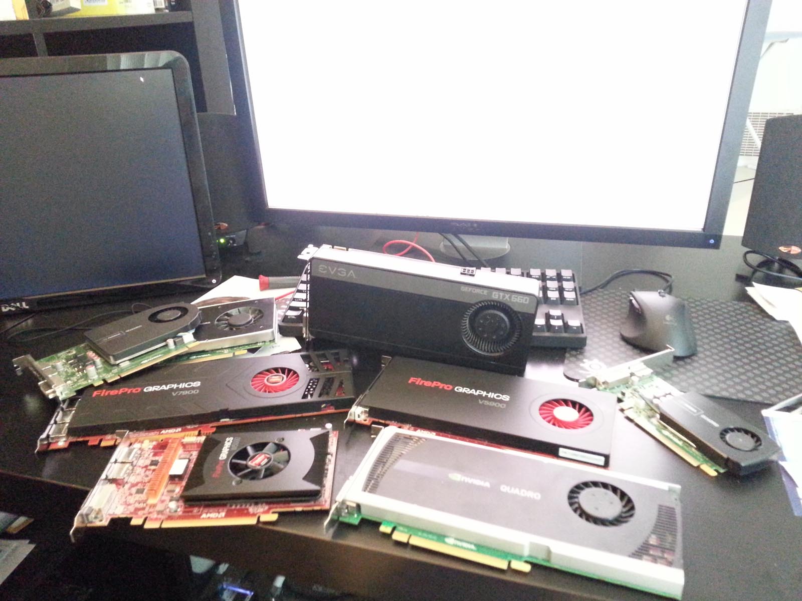

Dimitris Tolios Posted January 26, 2014 Share Posted January 26, 2014 (edited) Dmitris: Regarding my Firepro driver curiosity above, have you tested your W5000 on VRay RT by chance? Any better results than consumer cards? Do Intel iGPUs at least perform proportionately to their feeble potential (to shed light on the CUDA-bias vs. AMD’s driver neglect debate). There is not real difference I am afraid...sorry for not coming up with more detailed tests, I am literarly sitting on a pile of cards atm, but I have little time to organize myself into doing the actual test/research for a more elaborate test. This is what lies within arm's reach from my desktop @ home. That's: FirePro V5900 / V7900 / W5000 Quadro K600/K2000/2000/4000 (a few more not shown, all older) GTX 660 + Titan (inside "FooBox", it is "wet" so doesn't get out for picks anymore - edit: you can actually see the lil illuminated waterblock on the bottom left ). Guesstimating from past experience at least a couple of hours with each card, going through various benchmarks, trying to optimize that new capturing routine + 25M poly + 100M poly animation scene for 3DS viewport I was trying to devise, and I have to admit I feel overwhelmed...with my current schedule it means a card / per day of free time at best. Edited January 26, 2014 by dtolios Link to comment Share on other sites More sharing options...
Valtiel Posted January 26, 2014 Share Posted January 26, 2014 Ah, all good. Thanks for being willing to do so either way. So AMD's not simply holding real functionality to pro cards...Good news I suppose. The image is appearing broken for me. Is it just a photo of gpus? Link to comment Share on other sites More sharing options...
Dimitris Tolios Posted January 26, 2014 Share Posted January 26, 2014 Yeah, fixed the link to the pic...quality is "amazing", thanks to my phone I don't know how all "old"/"pre-GCN" OpenCL engines work fine with AMD cards including the much newer Adobe CC OpenCL routines, but Chaosgroup has issues with AMD drivers... Maybe they are right, maybe AMD is working closely with everybody but them. Not impossible, but hard to believe that there is nothing to blame on their side. Link to comment Share on other sites More sharing options...
