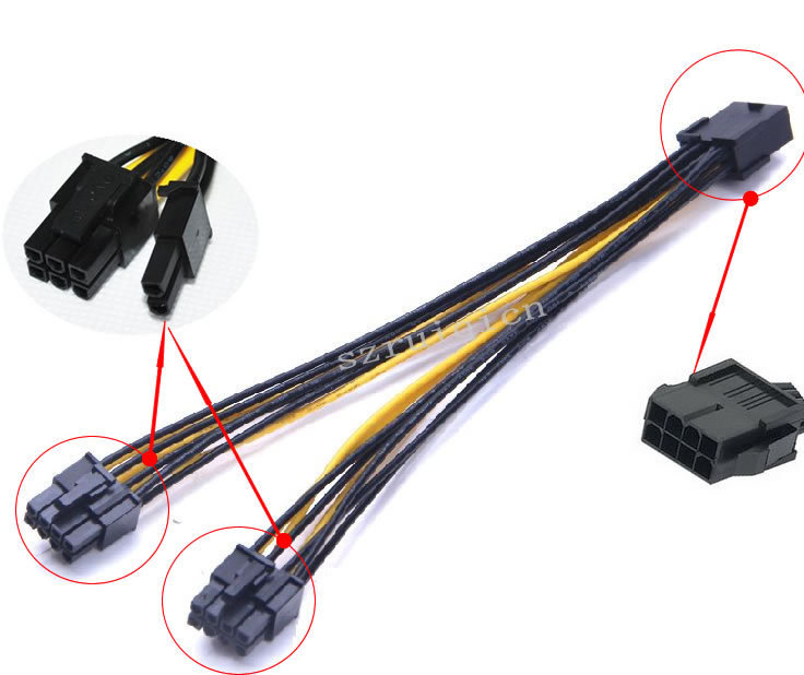

Nikolaos M Posted January 15, 2016 Share Posted January 15, 2016 I see. This psu has 4x12V rails and each one of them contributes with 18A. Only two of the rails (12V3 and 12V4) are destined to power the pcie devices, so that gives a combined 36A exclusively for the gpus. This could be enough, but I'm not sure. You'll need a cable like this: It's an 8pin to 2x8(6+2)pins. Connect it to the free 8pin port on the psu and with the other two 8pin ends you can power the 980Ti. Good think is that ATX (24pin), EPS (4+4pin) and all the other peripherals use the other two 12V rails without interfering with the power that goes to the gpus. I hope it works. If not, I'm afraid you should buy a new psu that suffices for the task. Link to comment Share on other sites More sharing options...

TomasEsperanza Posted January 18, 2016 Share Posted January 18, 2016 Well, the cables weren't available in any local stores, so I just settled with using the Strix, (and don't want to get into replacing PSU for this system). Currently I'm experiencing "Buyer's Remorse". (My own fault entirely). I can't get RT to work now, so I am experiencing no practical performance gains using Max, V-Ray, etc. and... this card is much noisier than the Quadro 6000; (to be expected, but I overlooked that). Lesson re-learnt: CG is time consuming even if you invest in new hardware, so best to appreciate current set up and keep working if you can. I think I might need to re-install V-Ray to get it to work properly. (Or I could re-install my old card and smash the Strix with a hammer! lol) Seriously though, the new GPU may yet redeem itself, if I can figure out why RT isn't playing nice. RE: Renderfarm config: I will probably eventually re-purpose current WS system as an additional CPU render node, once it gets too old, and is time to build a new WS. (This way all the WS components are of similar generation/age). Marcin - A couple of second hand xeons, with an SSD in a render node, sounds promisingly efficient to me; I don't regret mine. Link to comment Share on other sites More sharing options...
