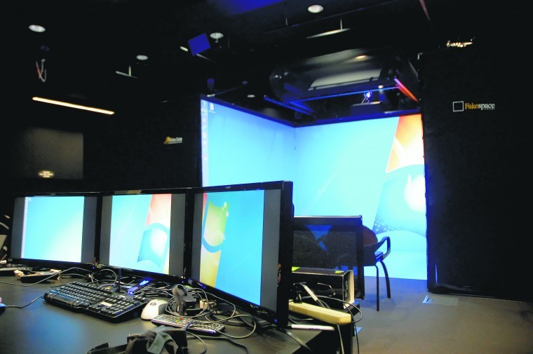

Scott Schroeder Posted October 12, 2015 Share Posted October 12, 2015 I used a 4 screen (3 movable walls + floor) stereoscopic CAVE back during my research time. It's not something you dabble in. It is vastly complex, expensive, and time consuming. We used Worldviz back then, but it was a piece of shite to use. It's all code based with a very poor UI. They have since gone to all Unity to create their environments. What you are doing, why not just use a Samsung Gear VR or Google Cardboard? A low budget CAVE looks like crap and combine that with an active shade view you start getting into the world of "Why bother?". The advantage of a CAVE is that it is immersive and 1-2 walls with a home projector(s) won't cut it for you. Our cave Link to comment Share on other sites More sharing options...
SgWRX Posted October 12, 2015 Author Share Posted October 12, 2015 i don't even know if using active-shade would work with a cave? that to me, would be a separate thing. a) active shade on a monitor b) a cave with 3d processing/glasses. the systems i'm seeing don't look like they use home projectors. a home projector could be more useful in a) active shade on a monitor. so far i'm seeing revit > unity > unity plugin > system used to run the cave projectors. one i've found is actually 3ds max > their system (world viz) which runs the system/cave projectors etc. of course, i've got to add revit into that workflow as that's where i get models from. so for me it looks like revit > 3ds max (materials and baking) > system x. or interject unity in there with other systems like visbox.com other than technical, how was your client's experience? overwhelmed, underwhelmed? thanks, Link to comment Share on other sites More sharing options...
