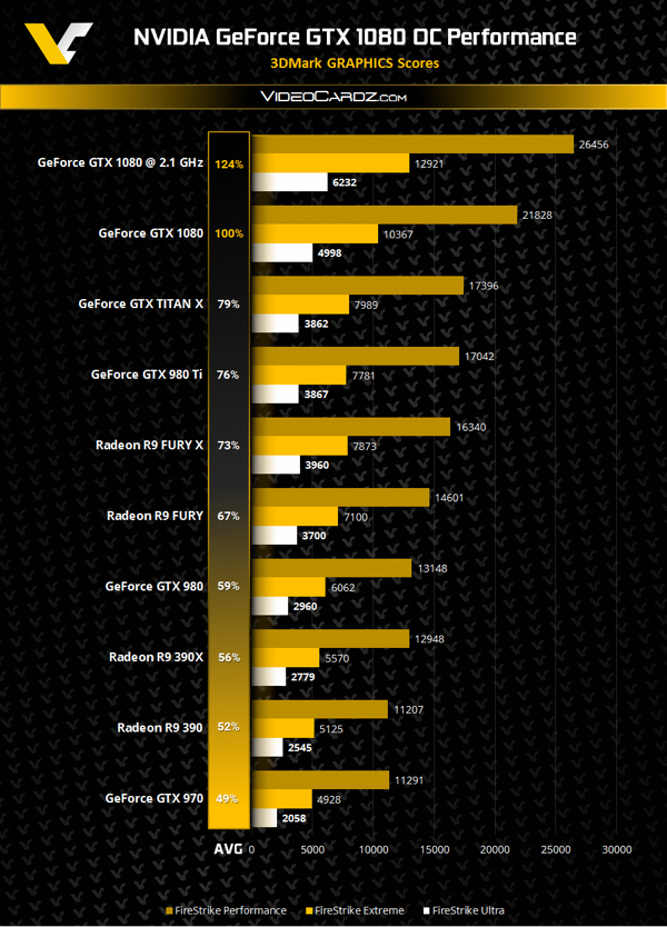

numerobis Posted May 14, 2016 Share Posted May 14, 2016 Some FireStrike scores of the GTX 1080 - not bad... http://videocardz.com/59882/nvidia-geforce-gtx-1080-3dmark-overclocking-performance Now we need some GPGPU benches - and a new Titan with 16GB+... Link to comment Share on other sites More sharing options...
