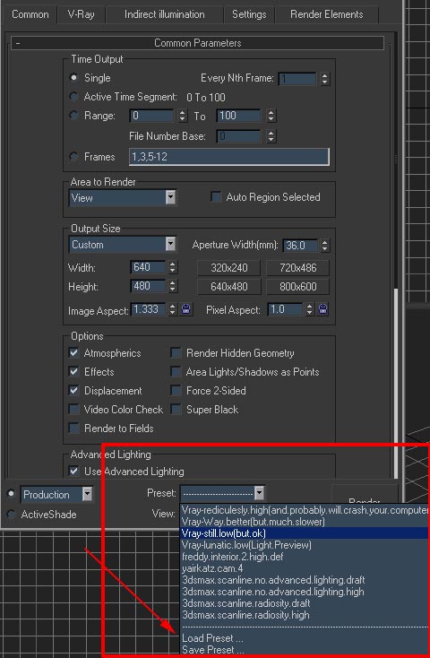

Larissa Holderness Posted July 26, 2016 Share Posted July 26, 2016 (edited) I have a few render presets that I like to use - they were saved from a previous version of VRay and have the file extension rps. Upgraded to VRay 3.40.02 yesterday and now I have no idea how to load these render presets. I've searched Google and read this (https://docs.chaosgroup.com/display/VRAY3MAX/Presets) however, they don't seem to be working. Also, I cannot post on the Chaos Group Forum ... or I would ask them. Suggestions (other than downgrading my VRay)? Thanks! Larissa Edited July 26, 2016 by digitalputty adding info Link to comment Share on other sites More sharing options...

Larissa Holderness Posted July 26, 2016 Author Share Posted July 26, 2016 (edited) Are you sure it's not a .cfg file (vray.cfg)? That's what I've always seen in the Presets File box. Yeah. I've used the *.rps just yesterday to set up a scene. It was an option at the bottom of the VRay (like this: http://www.krembo99.com/wp/wp-content/uploads/support/photo/Cgtalk-forums/20081104.cgtalk.settings.vray.jpg) Now it doesn't have that option. Edited July 26, 2016 by digitalputty Link to comment Share on other sites More sharing options...
Larissa Holderness Posted July 26, 2016 Author Share Posted July 26, 2016 Ok. I found the render preset button. It's been moved to the top of the render settings box. However, I tried to load the *.rps and it said it isn't compatible. No idea why. :confused: Link to comment Share on other sites More sharing options...
John Dollus Posted July 27, 2016 Share Posted July 27, 2016 for vray presets, you have to change the 'default' to 'advanced' under the vray settings tab for them to appear. Link to comment Share on other sites More sharing options...
