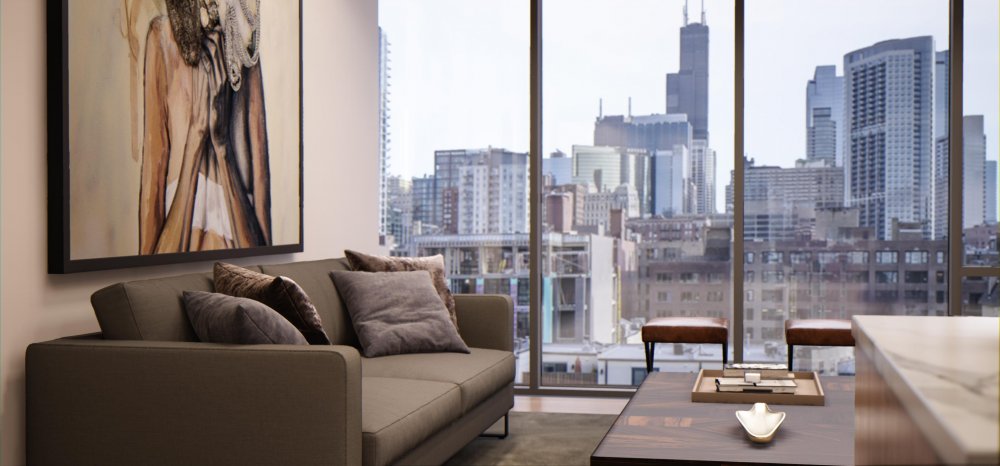

Tommy L Posted November 8, 2017 Author Share Posted November 8, 2017 Here' a couple of the renderings out of max/Vray for comparison with the UE results Link to comment Share on other sites More sharing options...
Tommy L Posted November 10, 2017 Author Share Posted November 10, 2017 (edited) And these are screenshots straight from UE. Edited November 10, 2017 by Tommy L Link to comment Share on other sites More sharing options...
