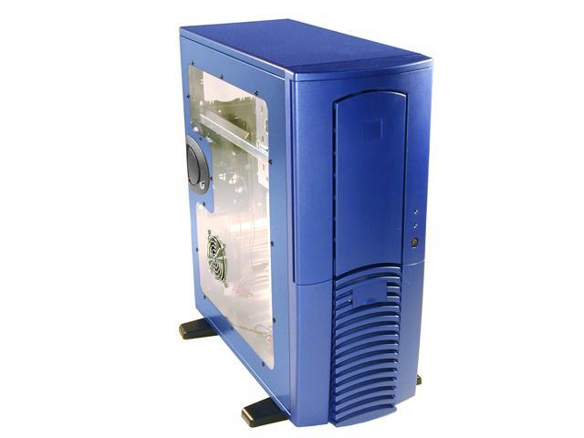

bigcahunak Posted July 2, 2003 Share Posted July 2, 2003 I think that the best on the market are the Chiftec cases which are also being used by Enermax. Here they are HERE Most of the time they would include all case fans already. Link to comment Share on other sites More sharing options...

xgarcia Posted July 10, 2003 Share Posted July 10, 2003 Greg, Just out of curiosty, what cases are you using (or recommend for that matter) in the Entomology Dept. you admin? Or better yet - what case would you recommend for 3D-at-home guy like myself. I saw your review of the Coolermaster ATC-110 - but it seems a little pricey for me. Like I said before - I using an Enlight 7327, which is what I see at my univ. computer lab, but the air flow seems weak at best. Thanks a bunch, Xavier Link to comment Share on other sites More sharing options...
David Knourek Posted July 10, 2003 Share Posted July 10, 2003 Hey xgarcia, I thought I'd jump in on this one and Im sure that Greg will agree with me when I say that if your looking for an inexpensive case with good design, airflow and cost effective then have a look at the Chenming cases ( http://www.chenming.com/cases.htm ) the steel ones are good but heavy but the aluminum ones are great (I have both here) and there are a couple other manufacturers making the same case design and some are cheeper than others so you should shop around, Im in Canada and not sure where the best prices are in the US but Greg or someone here should be able to tell you. On the other hand I recently got a Coolermaster ATC-201B-SX2 case (thanks Greg ) it was a little pricy but sooooo worth the money due to the extreem quality of the case. Theres actually a photo of it in the General forum under the workstation thread. Just my $.02 -dave Edit- Also Heres a link from where I got my Coolermaster case and they were the cheepest for what I was loking for in a case... http://www.sundialmicro.com/cgi-bin/sundial/atc201bsx2.html Link to comment Share on other sites More sharing options...
Greg Hess Posted July 11, 2003 Share Posted July 11, 2003 David's right on the money. I use chemming/chieftech/antec cases for all the departments machines. For the labs I usually go with mid towers like these... They're extremely easy to work with (sliding 5.25 bays, removable 3.5 bays, fan clips, easy open) and go for around 50-70 dollars, depending on whether you want a nice antec psu or not. For the professors (individual machines) since their mounted on the floor, I tend to go with the larger towers... The steel ones of these (like Dave said) are HELLA HEAVY. The alumnium ones are much nicer to move around . (The full towers go for around 60-100 depending on options) Both of these designs have front mounted USB/firewire ports (if the board supports them), and a joy to work with. Once you experience these type of case design, you get frustrated dealing with anything else . Coolermaster is the elite of computer cases. ELITE. You really pay a price premium for them. But daaaamn. They're so damn nice looking, very thick alumnium (very study) and have a very nice finish. Its akin to buying an audi over a VW. Both are fantastic vehicles, (even by the same company) but the audi definitely has the better fit/finish. Expect to pay 100-200 USD more for the same type of case buying from coolermaster then other companies. My personal cases are a Coolermaster ATC-110, A boxxtech 3Dboxx S5i, and a Shuttle SS51B Small Form Factor. And ya, I'm the admin. I'll take some updated lab photos today. I'd take individual photos, but its over 100+ computers...and I think the professors would give me an evil eye. Many companies use the same internals as the cases mentioned here. Alienware's new (beveled super cases) are just these cases with a nice exterior shell. Coolermaster even uses the internals of this case design on one of their own. Between the two...I'd have to say Antec is probably the highest quality with chieftech being the lowest. The nice thing about going antec though, is you get a top quality namebrand psu with your purchase. In some cases even a truepower...which I seriously recommend if your looking for new psu's. 3 YEAR warranty on the psu. Some companies don't even have a 30 day warranty. [ July 11, 2003, 05:06 AM: Message edited by: Greg Hess ] Link to comment Share on other sites More sharing options...
