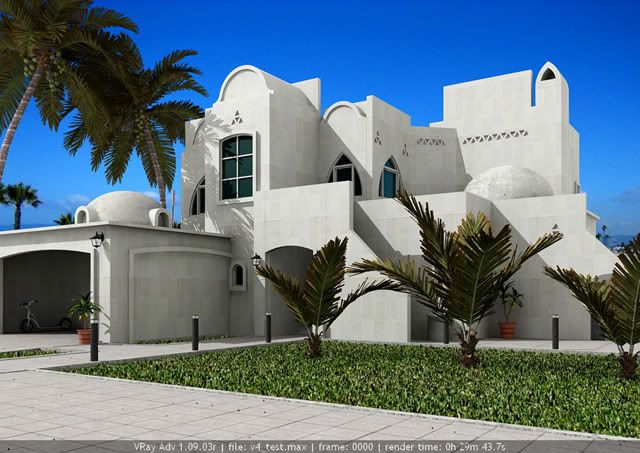

I'd agree with using the Onyx system -- here's a rendering I did this week that we landscaped in max with their software. I think it's pretty effective in the way that it takes on the lighting of your scene, plus it makes offering multiple views very easy compared to Photoshopping multiple angles.
The flowers are a little tedious to work with, and we haven't created a significant library yet. They're a bit of a sore thumb in this example, but I think going forward we'll get better and better results.
Good luck!
Shaun
