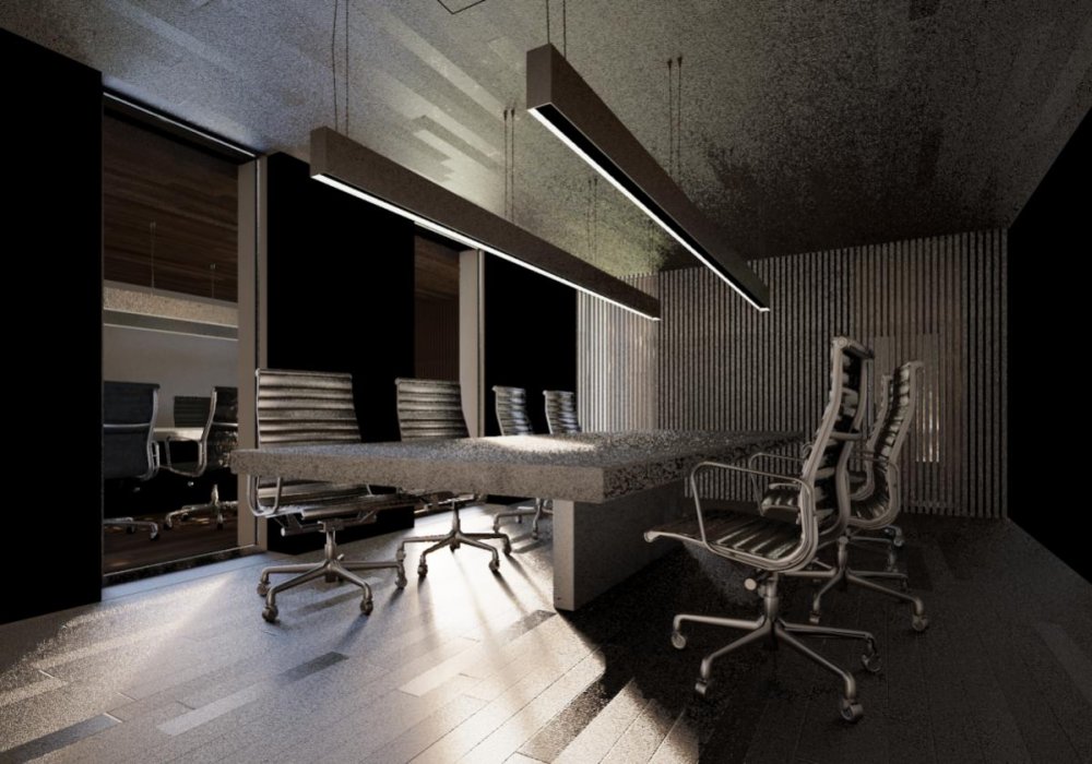

nykegoddess Posted February 19, 2008 Share Posted February 19, 2008 i am rendering a gym, and there are white spots on it. i have attached a picture of both the gym and render settings. please i need help to get rid of the those unsightly white dots... also my render time is about 4hrs 45min... i need to cut it down oh and i know that the picture is too bright.. i will tone down the lights but the white dots r killing me! they appeared even when the room wasnt too bright enough. i appreciate any help i can get... and this is really urgent. this is my firts post by the way thanx Gym: Render settings: Link to comment Share on other sites More sharing options...

nykegoddess Posted February 21, 2008 Author Share Posted February 21, 2008 i did an crop render of the spotty areas, the dots r gone. am sorry i didnt reply immediately that were, i went out of town on business... anyways, am rendering the image again with the light multiplier turned down to 1. but the dark mult is still 2.35. i am currently working on the lights now, to tones things down. i really appreciate the help i got here. i will post the final image once it is rendered. thank you so very very much for you help. oh btw way... i used vraylanconze set to 2, and i turned on sub-pixel mapping and increased rQMC noise to 0.01 and the dots dissapeared. i will render the regions ot again with one by one, so i know wat caused the dots and post it here too. once more thanks for your help! CGarchitect rocks :-D Link to comment Share on other sites More sharing options...

nykegoddess Posted February 21, 2008 Author Share Posted February 21, 2008 sth is wrong.... it isnt sharp enough... the render settings is still the same, but use lancoz filter for anitaliasing, sub pixel mapping is turned on, noise thrsh: .01 and set bright mult to 1.... sth is wrong with it.. please wat am i doing wrong? and this is the render setting with the corrections i stated above (for those who dont want to go back to the previous page to view the image) which is lancoz filter, size 2 sub pixel mapping: on rQMC noise filter: 0.01 bright mult: 1 Link to comment Share on other sites More sharing options...
nykegoddess Posted February 21, 2008 Author Share Posted February 21, 2008 sorry wrong image... that is the new render and this is the render setting CHANGED SETTINGS ARE: lancoz filter, size 2 sub pixel mapping: on rQMC noise filter: 0.01 bright mult: 1 Link to comment Share on other sites More sharing options...

Rendermedia Posted October 3, 2008 Share Posted October 3, 2008 Hi All, I have gone through this thread and the render set ups, however I am not sure where I am going wrong as I am still getting those white dots but only on those objects that are reflective Plastic You can see it’s noticeable on the Green and blue button objects I have uploaded a small 25 frame segment here, www.rendermedia.co.uk/downloads/Web/dots.mov I would appreciate any assistance on this kind Regards Mark Link to comment Share on other sites More sharing options...
Arnold Grove Posted November 1, 2008 Share Posted November 1, 2008 I didnt try anything of the sort, people suggested I use caustics, turn of caustics for the sun, sub pixel, various antialiasing filters bla bla bla. I turned off the camera visibility and BAM! Gone, Done! When i right click on the vray light to get to properties, that option is greyed out and i cant get to it even when i check 'By Layer' How do i get this setting active? Ive posted about this before and I am also still having the problem. I have a simple room scene with vray light spheres - Ive tried all suggestions here using all the settings and still have the spots. Checking Sub-Pixel only gives me a warning in the Vray log saying the 'rendered result my have inccorect brightness' but I still get the spots. I even turned the cuastics value in the vray properties to 0 and still get the spots. The only time I get these is when I use the sphere lights w/ GI on. All other lights and settigns are fine. Im ready to tear my hair out Link to comment Share on other sites More sharing options...
